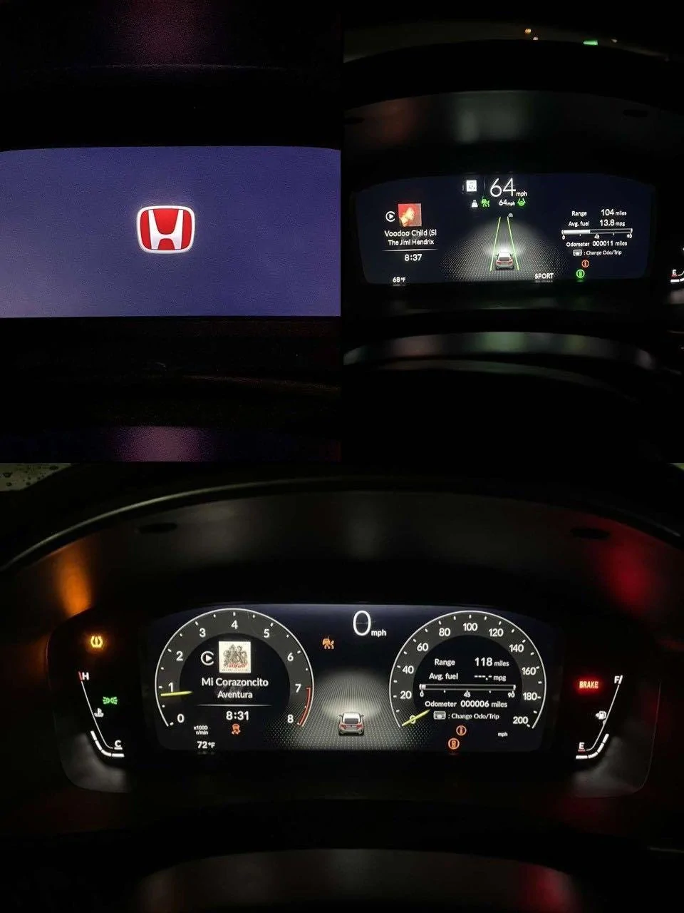

Hey y’all. Recent owner of a 2022 Civic Si CBP and have been wanting the full digital dash w/ shift lights ever since I found out the CTR had shift lights and the American SI came without a full digital cluster.
after completing the swap w/ steering wheel, I’m happy to say that everything works as expected and even my Ktuner Multiple Maps work with the next steering switches & cluster. The cluster still responds and allows for me to change maps and set my 2step. And finally my redline on the CTR cluster matches my tunes redline too.
I can also concur that the shift lights work and will light up 100% and the dash will chime to shift but you have to get into the rev range that a CTR would. With my redline being raised, on long pulls, the shift lights will respond perfectly.
Thank y’all for the help to make this happen
- Also putting this dash in allows for new controls to head unit such as the shift lights, chime, etc.

I have not gotten the Type R mode to work but Ktuner just came out w a screen layout that is almost the exact same and been using that.
I just bought a new steering wheel & cluster from Type R and swapped those both over exactly how Xcelent says.
I did not reprogram my mileage but I’ve been using my Trips to track mileage and oil change intervals so it isn’t too bad
