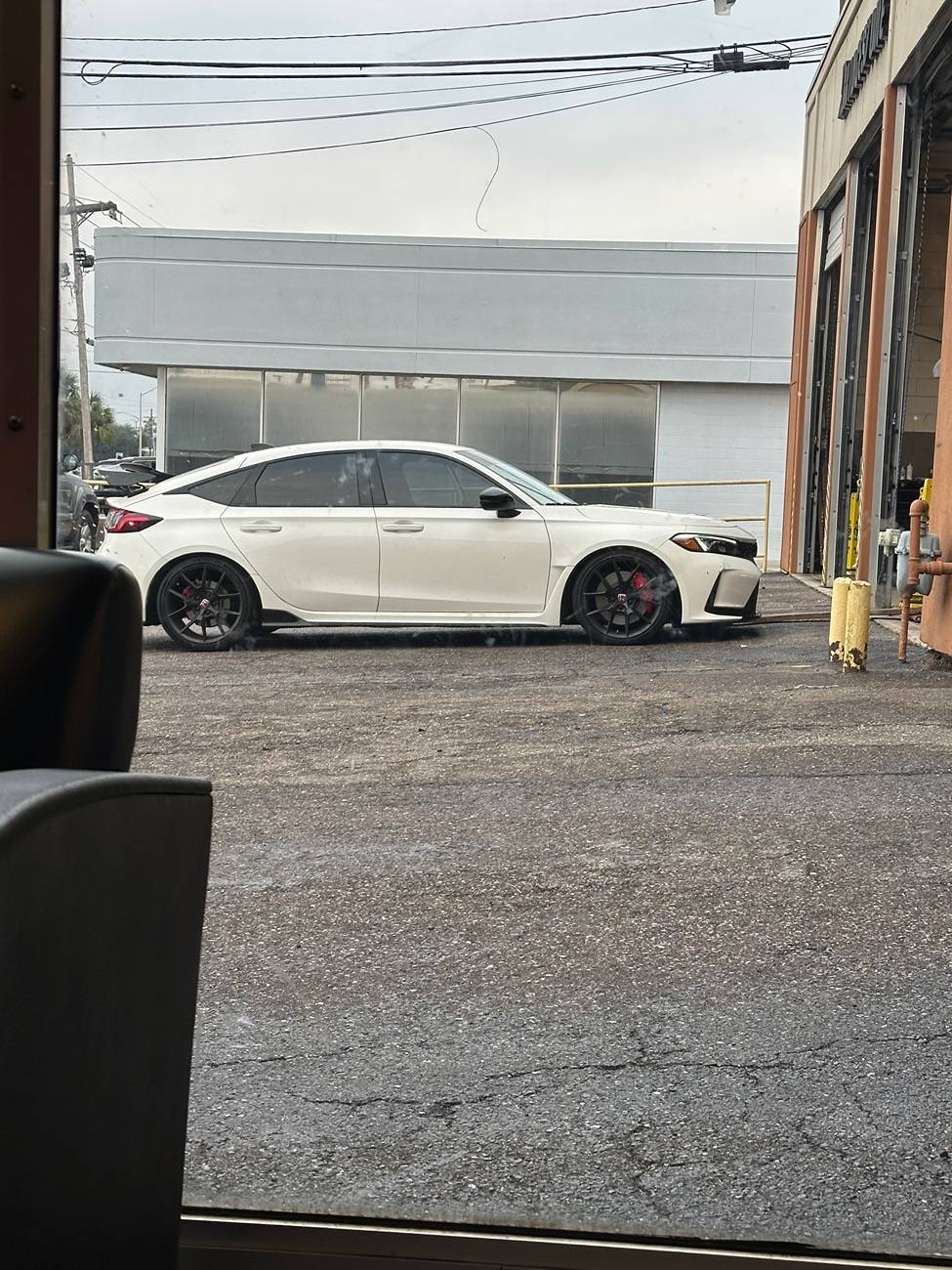

Very happy with my pro kit even on New Orleans roads. I originally had no plans to lower the car, but then I got a deal on 18's that I couldn't pass up and I decided I wanted wheel gap less than I wanted to swap springs.
Ride is noticeably firmer than stock, but not harsh and some of the stock "bounce" seems to be removed. My wife doesn't even complain so that should tell you all you need to know.
Pic is from the alignment shop yesterday. All numbers back in the green except LR camber which is sitting at -2.4 compared to RR at -2.0. I have no plans to add a camber kit at this time.
