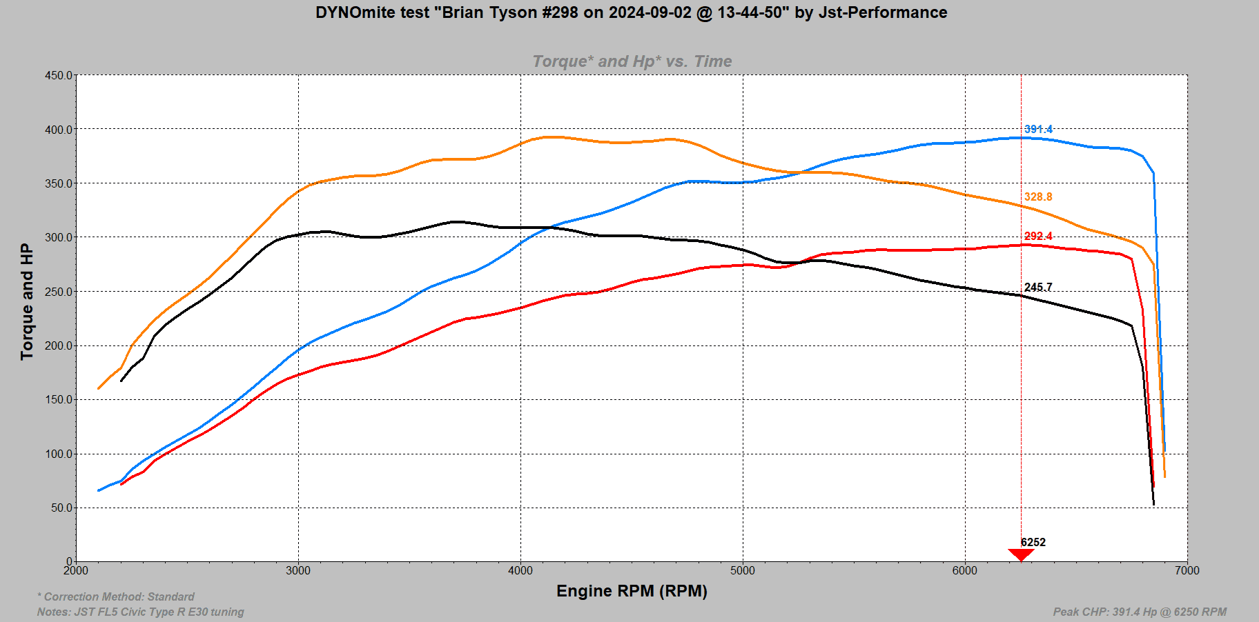

We have been doing extensive testing and tuning on our shop FL5 for the past month using Cobb Software and the Cobb Accessport.
We are currently sitting at pretty much a dead even gain of 100WHP over stock with only a PRL intercooler, E30 fuel, and our custom tuning Via the Cobb AP. ( check dyno chart below).
We will continue to push what we can using this software, but so far i can say im very impressed. Especially for the short amount of time that Cobb support has been released for these cars.
on top of the things that come on the Cobb OTS maps such as Launch Control and Flat Foot Shifting , I have already figured out Ethanol tuning , upgraded fuel system tuning, Boost by gear, power levels/ boost by gear per drive mode, and a few other things.
Look for more posts in the near future, We actually have just signed up to be a Forum vendor a few minutes ago.
11th Gen Honda Civic Cobb Tuning Accessport FL5 support starts 8/5/24 FL5 stock vs E30

- New to the forum here, but not new to Type R's!
I used your guys for my Focus RS tune! Are you offering E30 virtual tunes the same way you do for other platforms?

Awesome results! So just the hondata canflex and that's it, no additional fuel pumps or anything?
If so, that's awesome and I can't wait to purchase the canflex from hondata. I'm getting the tuner, chipped and a custom tune from drob this weekend. The canflex will be next along with the PRL HVI and titanium inlet.
I can't wait to make this engine come to life.

The Canflex is for another software won’t be with this one. They will probably come out with their own version eventually.
Websitesdown
Jun 17, 2024
275
176
So he did a locked mix tune basically. E30 blend period so to say, no flex ability.
Correct. Cobb does have plans for true flex fuel integration.
I just finished up retuning our FL5 with an XDI pump and injectors on 93 octane, i will likely be tuning it on an E50 Blend or full E85 when i get a chance
Yeah just wanted to clear it up for them. And looking forward to it. I’m currently tuning mine on ethanol also testing different mixes just using another software.
