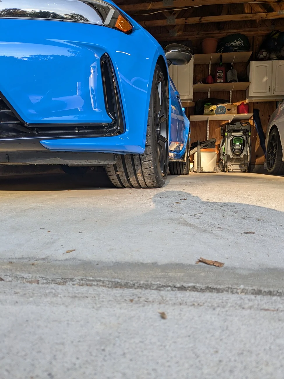

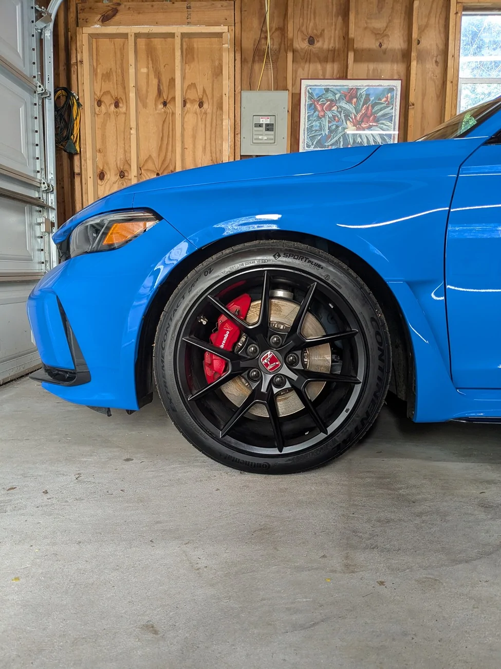

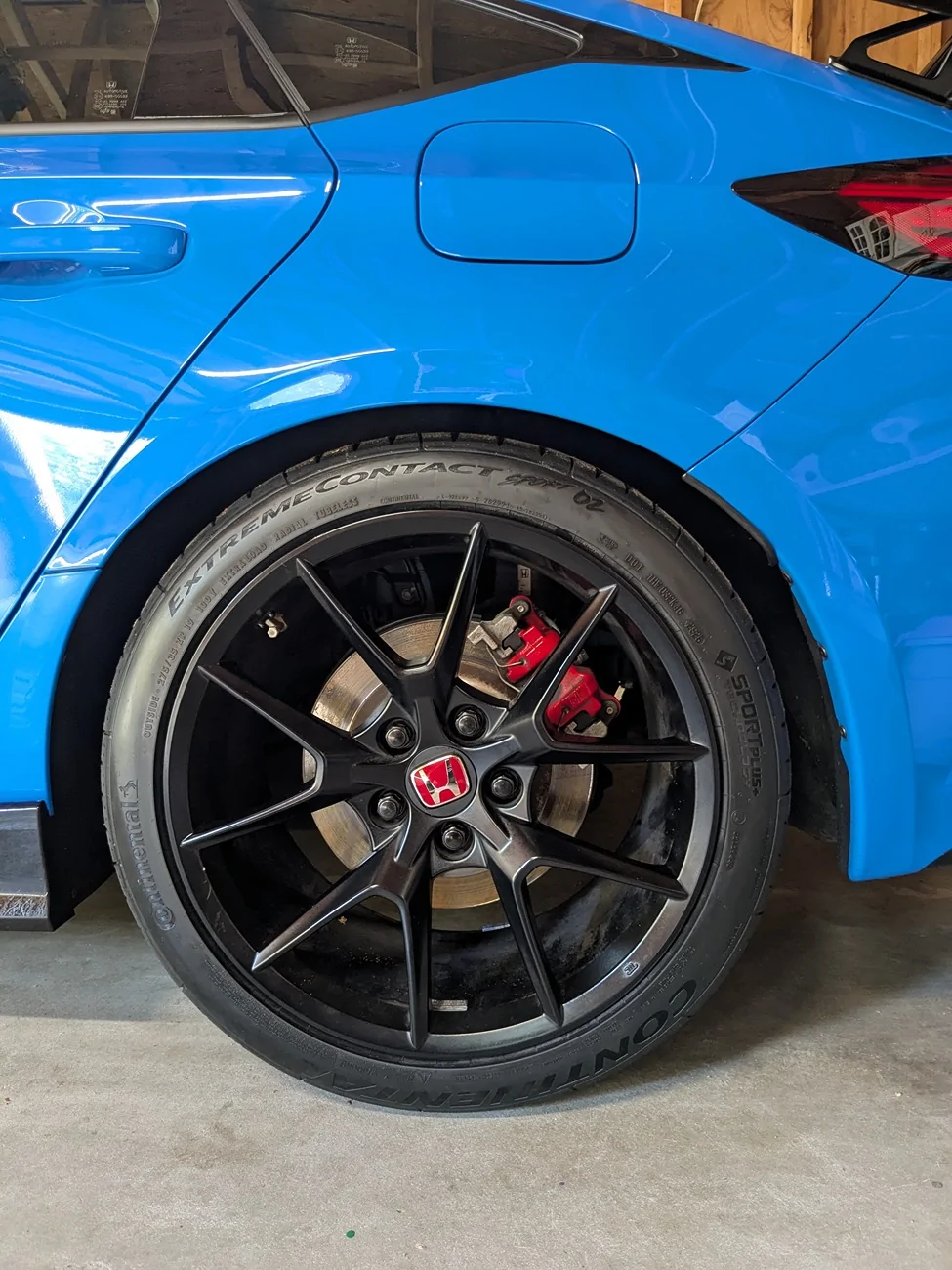

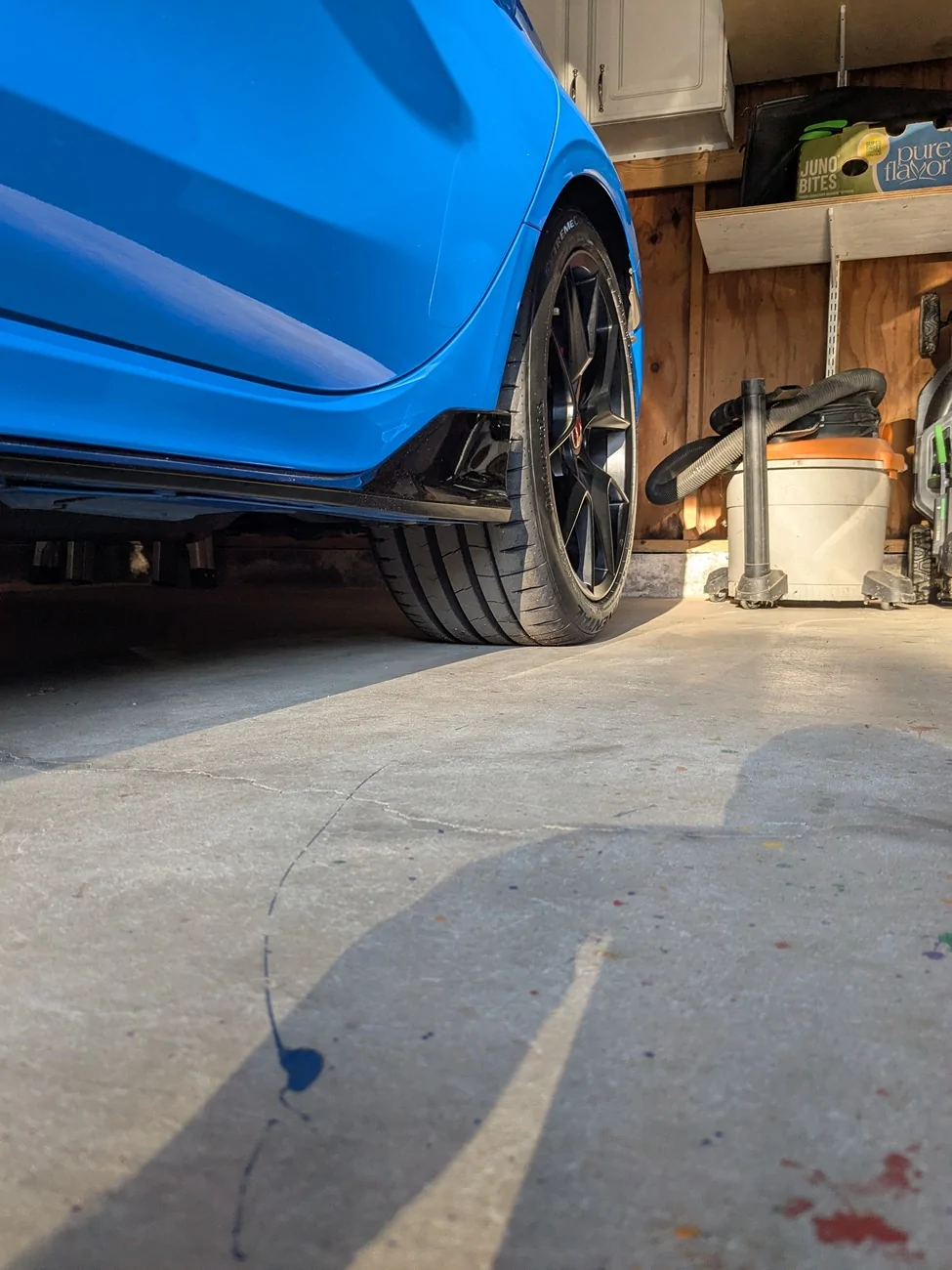

I'm on 275/35 R19 on 19x9.5 +43. I think anything beyond that may rub, +35 would need much more camber I'd think to not rub..

Ideally I think I could get away with a 275/30 or even 285/30. I was too ambitious with 275/35 but it did ride a lot better!

Initially I was on Eibach Sportline springs with the 275/35 19s no rub with a +43 offset. When I switched to coilovers to go a little lower it rubbed but that was because it needed alignment after installing the coilovers. If you stay stock hight or go with springs I think you'll be fine. It's the offset beyond +43 or +40, that's where I think you'll rub without more camber.

I am running the stock 19's with a slightly taller 35 profile tire with +40 (stock offset of +60 - 20MM spacer) in front and +35 offset in the rear(stock offset +60 - 25MM spacer) with a drop on H&R's (less than an inch) on 265 width with no rubbing . I stated above the offset might become an issue because 275's are .4 inches wider than the 265's so I get it . Things can get pretty tight but .5 an inch can make all the difference between rubbing or not.
