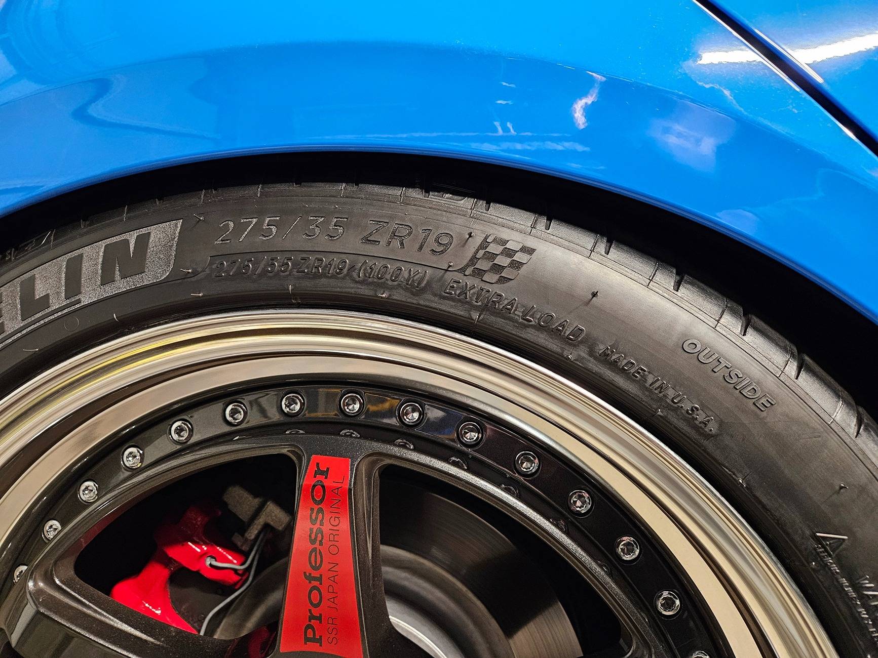

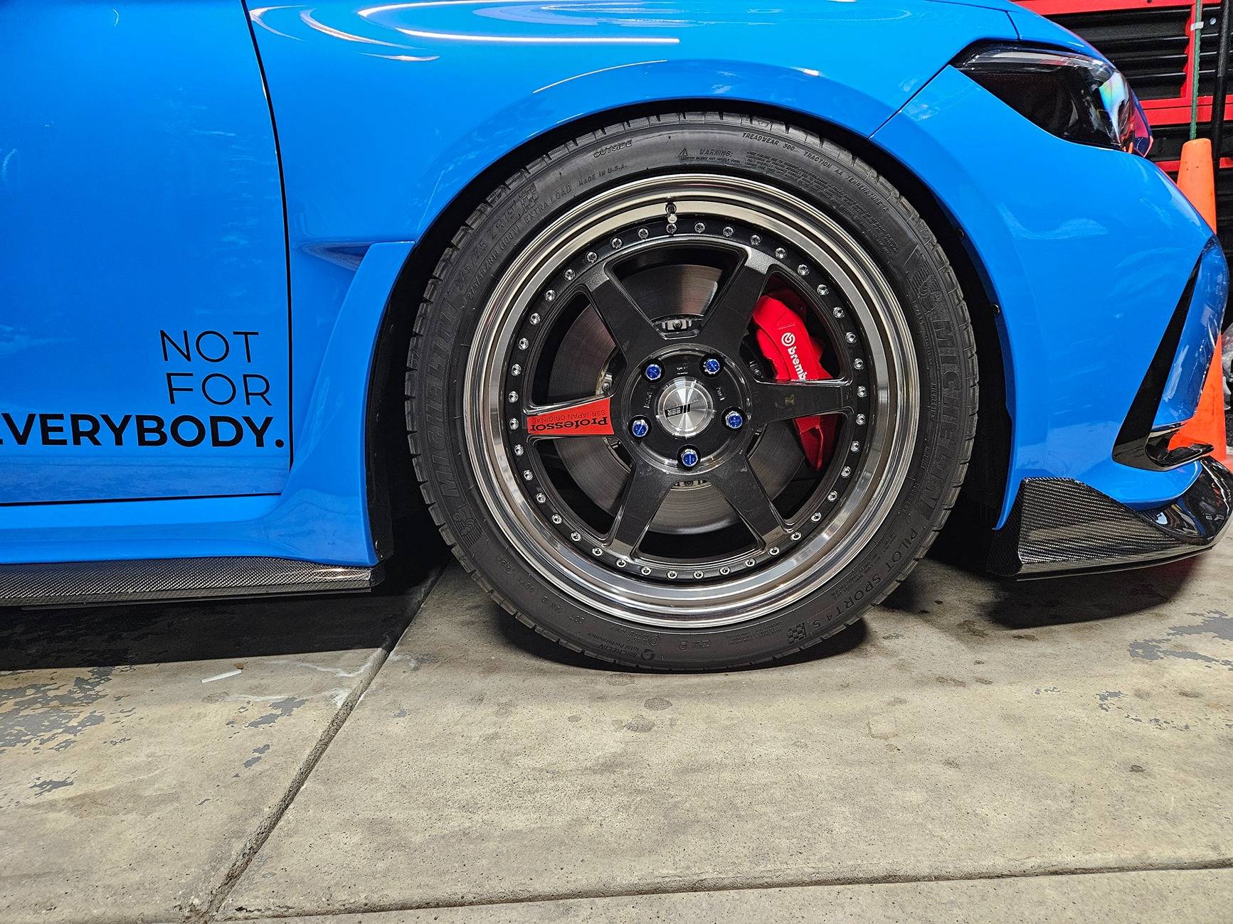

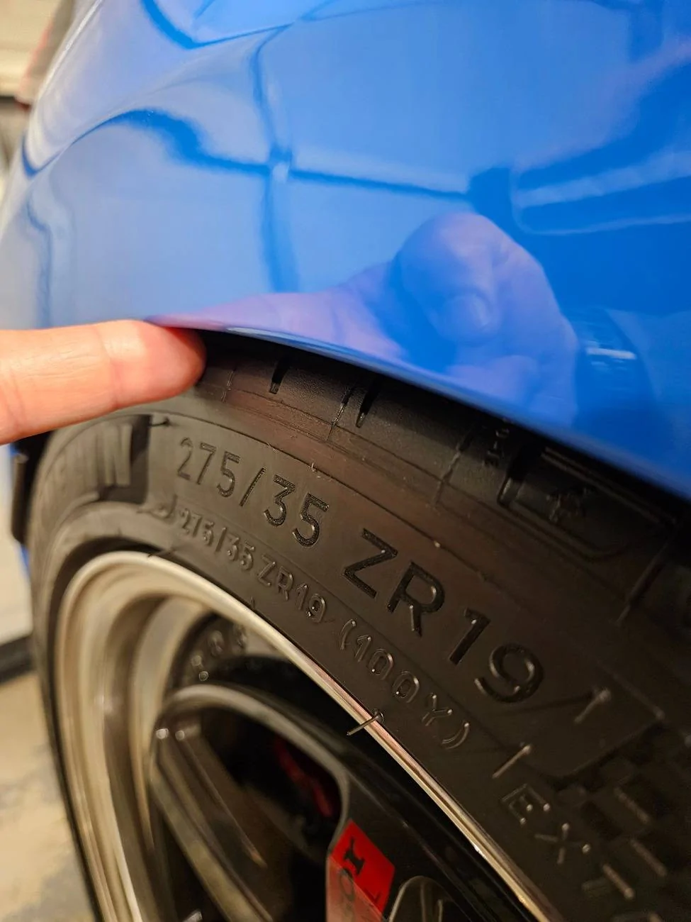

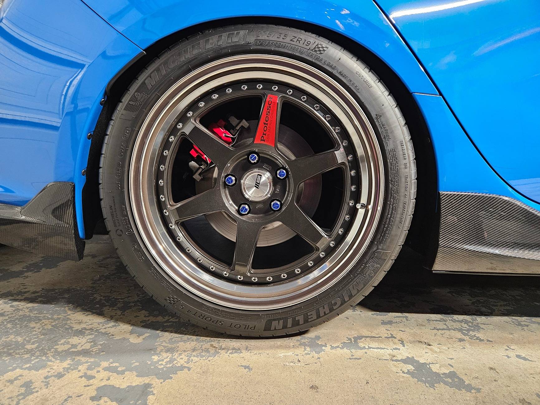

How many finger gaps do you have? Pic? Thinking of doing same for that cushion.
FL5R-05967
Allan
Jul 30, 2023
CA
23 BB CTR, 93 NA Miata 72 Pontiac
Might be hard to tell due to the lighting, my finger can only go so far since the tire is tucked under. Hope this helps!
