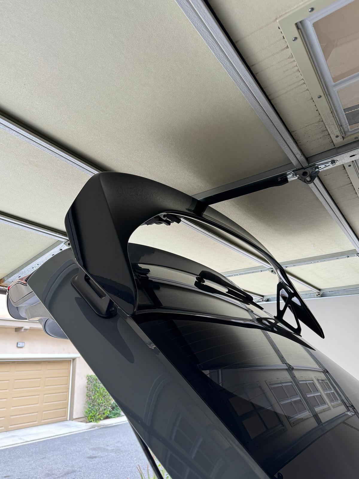

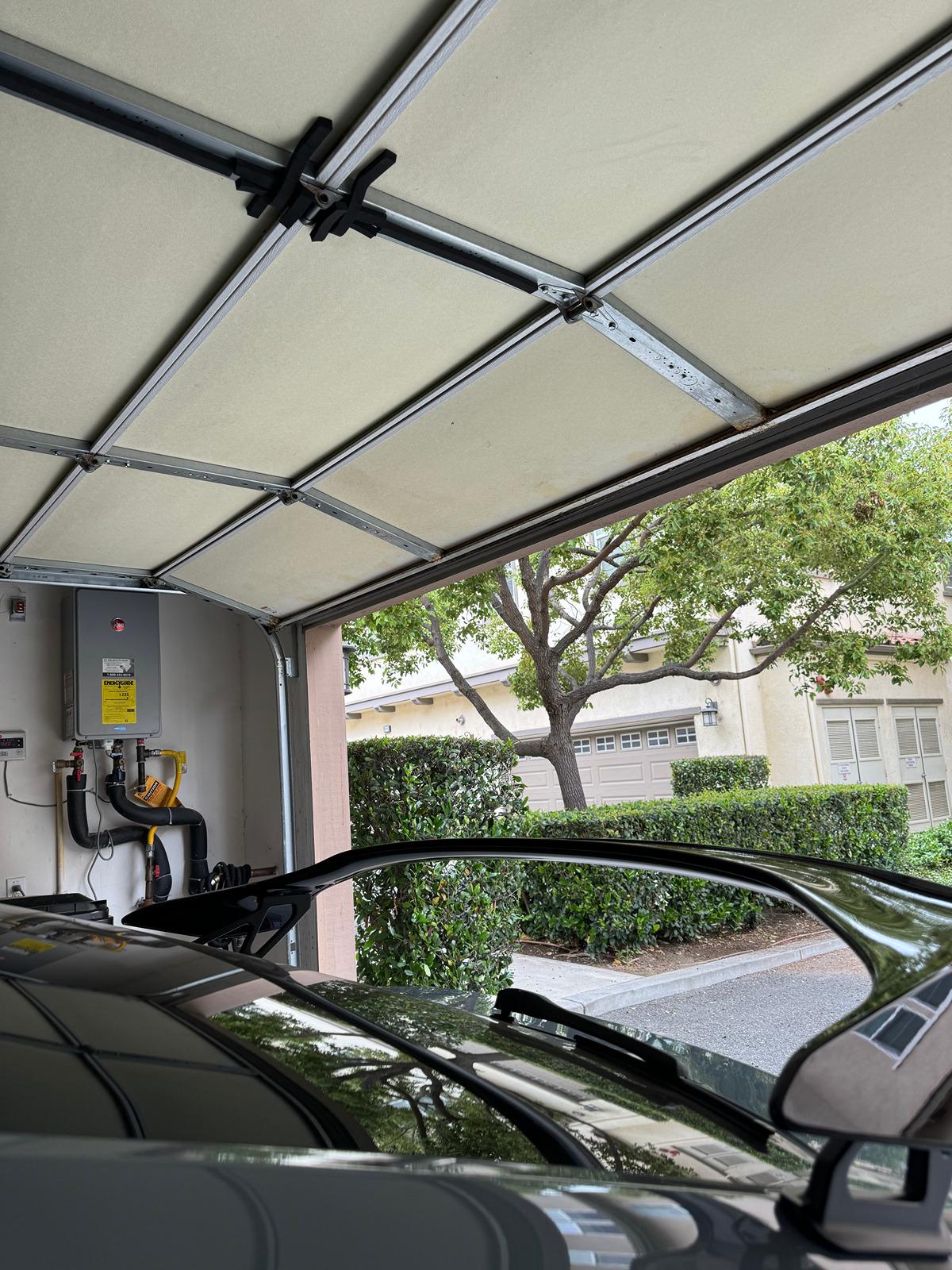

Leftover foam padding from another home project is my solution for now!
11th Gen Honda Civic Rear Hatch Opening Height Adjustment? IMG_1166
11th Gen Honda Civic Rear Hatch Opening Height Adjustment? IMG_1167

That's a great idea! Totally gonna try this out haha. I have the same issue as well with my garage door.
I'm willing to get even more ugly about it with some noodles or better foam. I had these lying around.
It helps for the situations that I might forget about the garage door or if my partner decides to open the back before I get to it.
I'm consciously making an effort to open it carefully or slowly, or park backwards if I h ave a lot of unloading to do.
