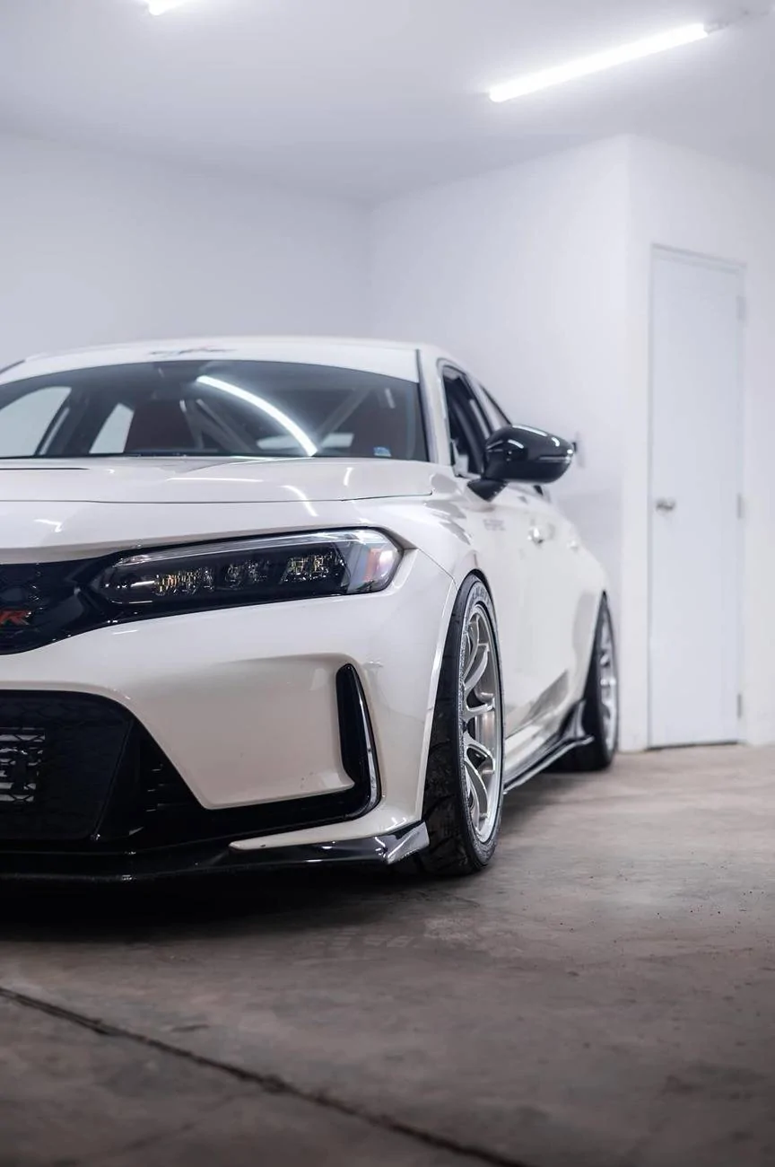

Risky color but I love it Rays Wheels ZE40 M-Spec in racing green
18x10 +40 is probably the best FL5 fit.
Im consider going to 275 to get a less stretch look on the tires.

Just watched love how excited you are about those wheels 🤣 I like the green but could never bring myself to do it. Can't wait to see it on the car. I run 18x10 myself and 275 is the right choice.
I really like the bronze too and surprising liked the black. Much better than the boring black we got stock.

I ran 285/35 hankook rs4 on 18x10 +45 before, lowered on spoon springs no rubbing anywhere.

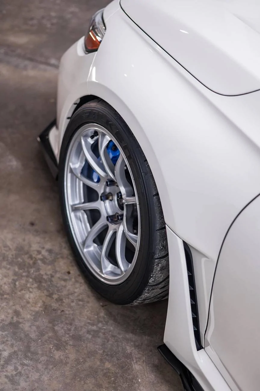

Did this setup require any fender rolling, or additional upgrades to fit without rub issues?
phothrottle
phothrottle
Phuong
Jul 17, 2023
60
156
309
2023 honda fl5
No fender rolling or modification needed. On the FL5 you can't even roll the fenders even if you wanted to.
