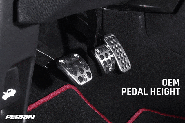

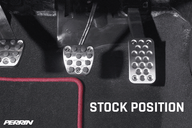

Competitive parts move the accelerator pedal up too high, placing it even with the brake pedal at rest. This makes heel blips difficult as you have to raise your foot to reach the accelerator. The PERRIN relocate plate is specifically designed to place the accelerator pedal on the same plain as a depressed brake pedal for perfect heel-toe blips while braking.

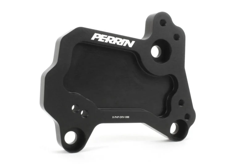

The PERRIN Accelerator pedal relocate has 2 horizontal positions. One running tight and parallel to the brake pedal. The other angled, with the bottom of the pedal running closer than the top. You can change the position anytime by simply re-installing the part to see if you prefer heel or side foot throttle blips.

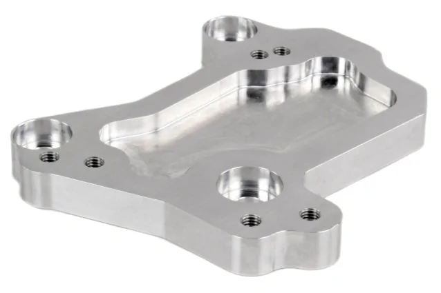

The PERRIN Accelerator Pedal Relocate is CNC machined from lightweight aluminum for a perfect fit.

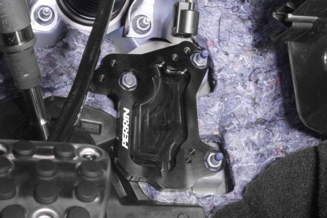

Simply un-plug and unbolt your acceleration pedal. Install the PERRIN relocate plate and reinstall the accelerator pedal.

Yes, you have to cut down one of the studs that it mounts to, and it's a bit of a PITA if you use cheap dremel cutoff wheels that shatter every 10 seconds (so find good quality cutoff wheels!), but it's very worth it to get the pedal in the right spot.
FWIW, I believe I measured the competitions part at 28mm thick vs the Perrin part at 12mm thick. That difference made all the difference for me.

If you look at the OEM throttle pedal, it is mounted on three studs. Actually, just go unclip the electronic connector and undo the three nuts and take the pedal off, and it'll all be very clear. Perrin gives you a couple spare nuts to thread onto the stud being cut so you know where to cut it, and then you just cut a part of one of the studs off. Remove the spare nuts, and install spacer and then install pedal. It's not all that difficult, and there's enough stud left to put the pedal back on in stock form if need be.
Not sure what you are saying about something that won't fit properly; the pedal spacer fits and works perfectly. You just have to do a little surgery to get there, which they give explicit instructions for. Very worth it IMO.
