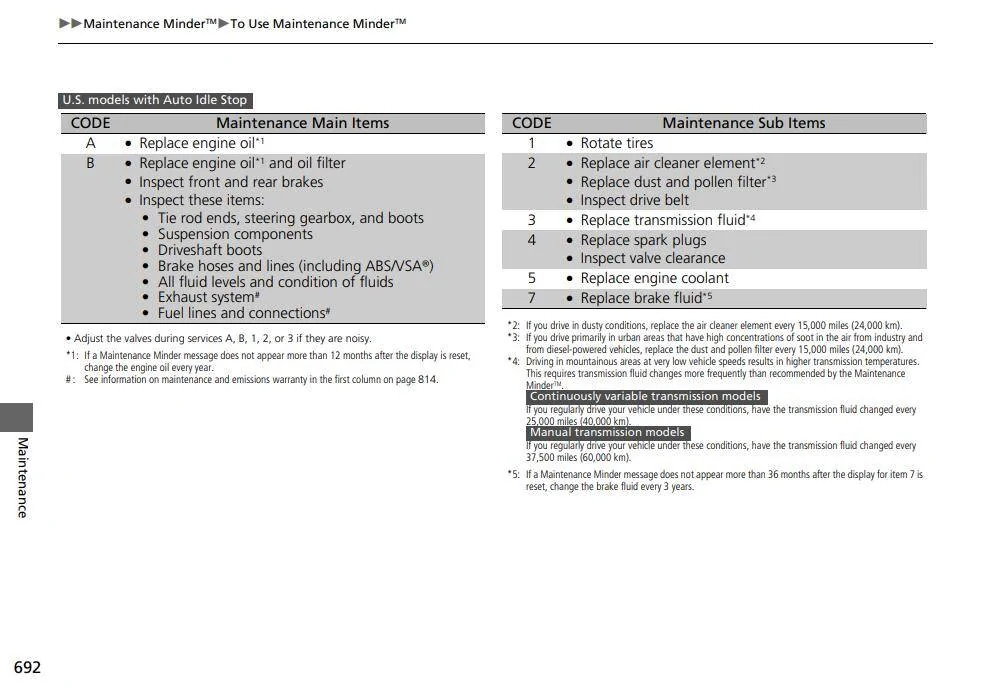

I have a 2024 Civic sport (K20C2 NA) manual with 6200 miles. My car shows 15% oil life remaining. The manual (see below) states to change just the oil when code A appears, which I'll do. The dealer near my house states to change the oil every 7500 miles. For the past 20 years, I used synthetic Costco or whatever synthetic is on sale (Valvoline, Pennzoil, Castrol, etc) and OEM filters every 7,500-10,000 miles. My past cars were 4 cylinder non-turbo daily drivers (except the SR20 S13, where I changed oil every 3K), and I never had a problem. I do the same for my family member's cars. I have tame driving habits (I very rarely rev past 5K). If I had a Type R and I drove aggressively, I would change the oil at shorter intervals with higher grade oil.
