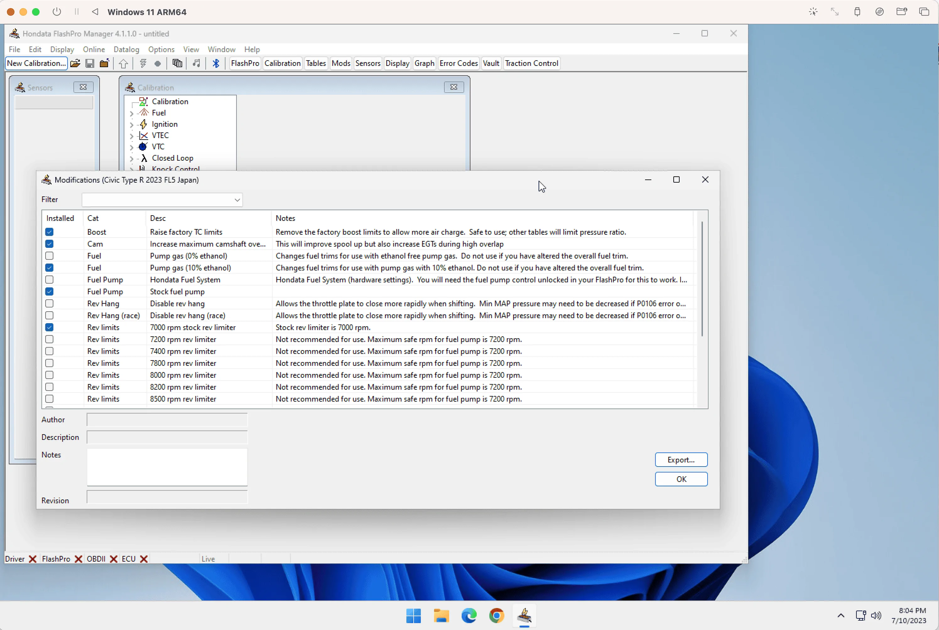

2023 BB Type-R
@jayely14 I used a free virtualization program called UTM (https://mac.getutm.app/) to run Windows 11 ARM64 edition on my M1 Mac. I was using it for Ktuner software. But I just installed FlashPro, and it seems to be working fine.

Thanks for the help guys! Good to know once you install it you don't really need a PC anymore.. I will just try a free trial and be done with it then. Easy enough!
