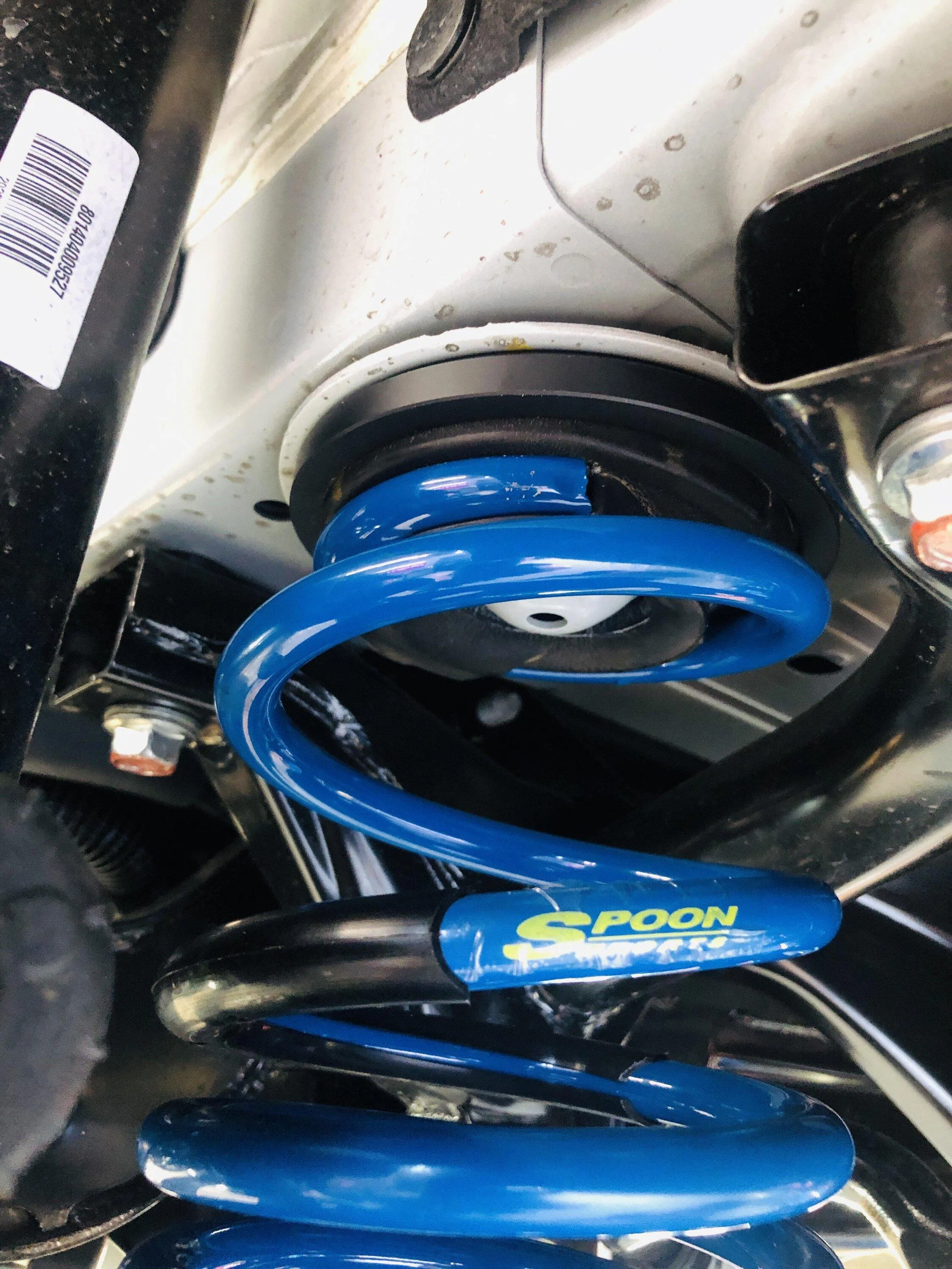

I'm currently on Spoon's and very satisfied with the ride. I've got both bump stops cut down 10mm as per the instructions. Only thing about the Spoon's is that they sit lower at the back so I've got that corrected by designing my own spacers that sit on top of the rear spring (between the rubber insulator and the body).
Perform very well on track.
Check my build thread for more info on the spacers.

Yes, this is their explanation - but anyone who has Spoon springs fitted to the FL5 agree their car sits low in the rear. Measured to be 10mm lower at the wheel arch with a full tank of fuel.
