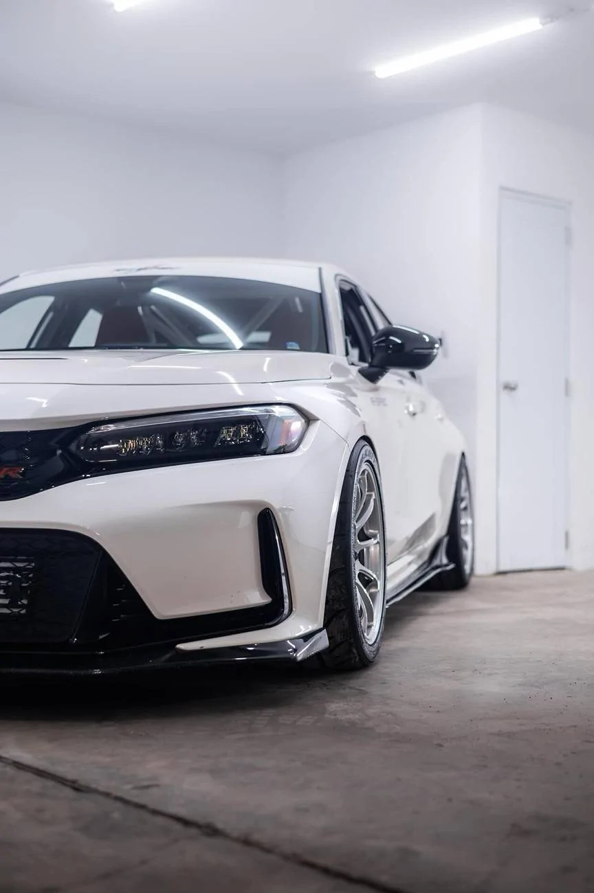

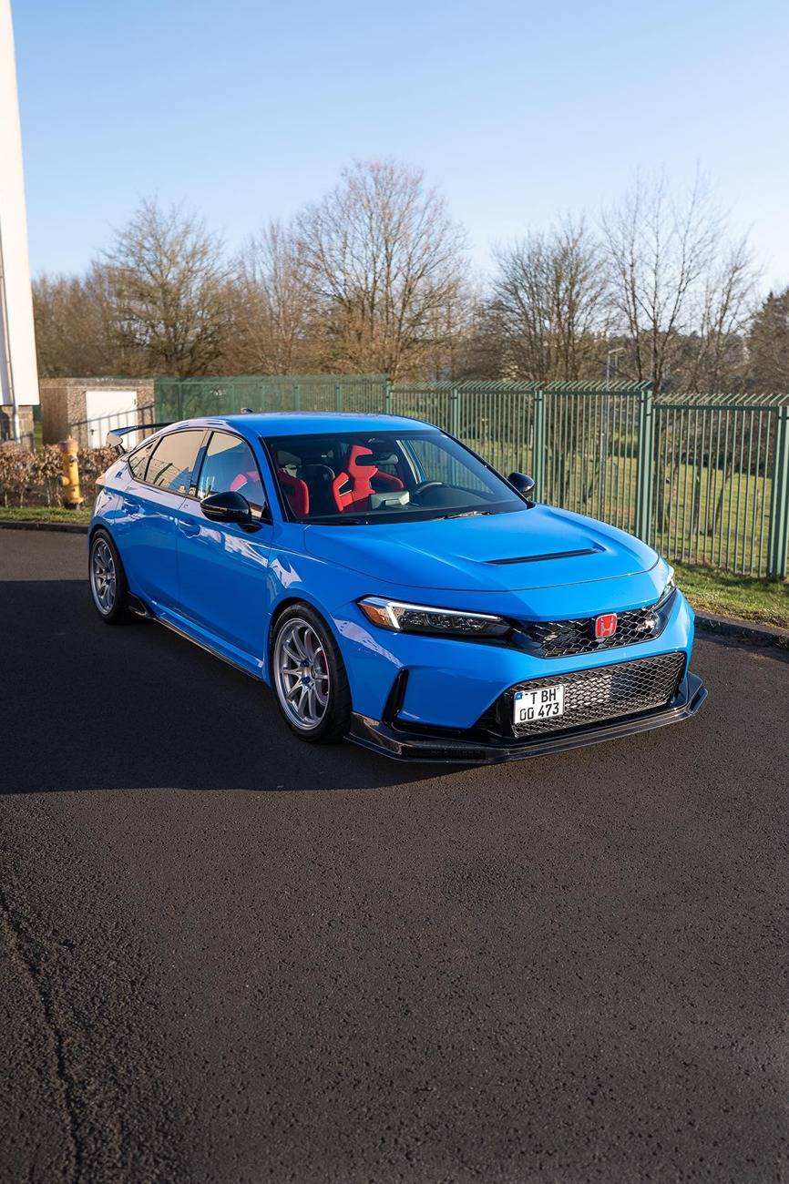

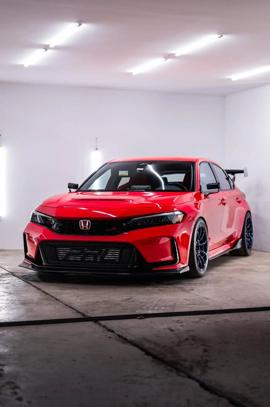

All of our customers run 275/35 on 18x10 +40. All ranging between different suspension setups.
Wow thank you for these photos. Great job on the setups.
any issues with rubbing on any of those setups you’ve seen?

no rubbing on any of these setups. 275s fit like a glove with a lowered suspension setup.
