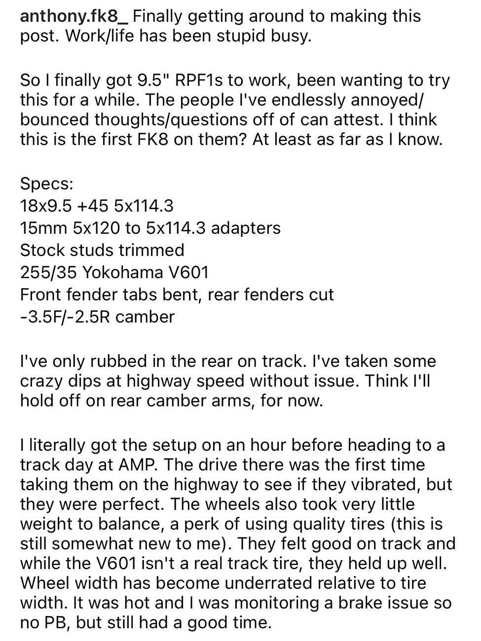

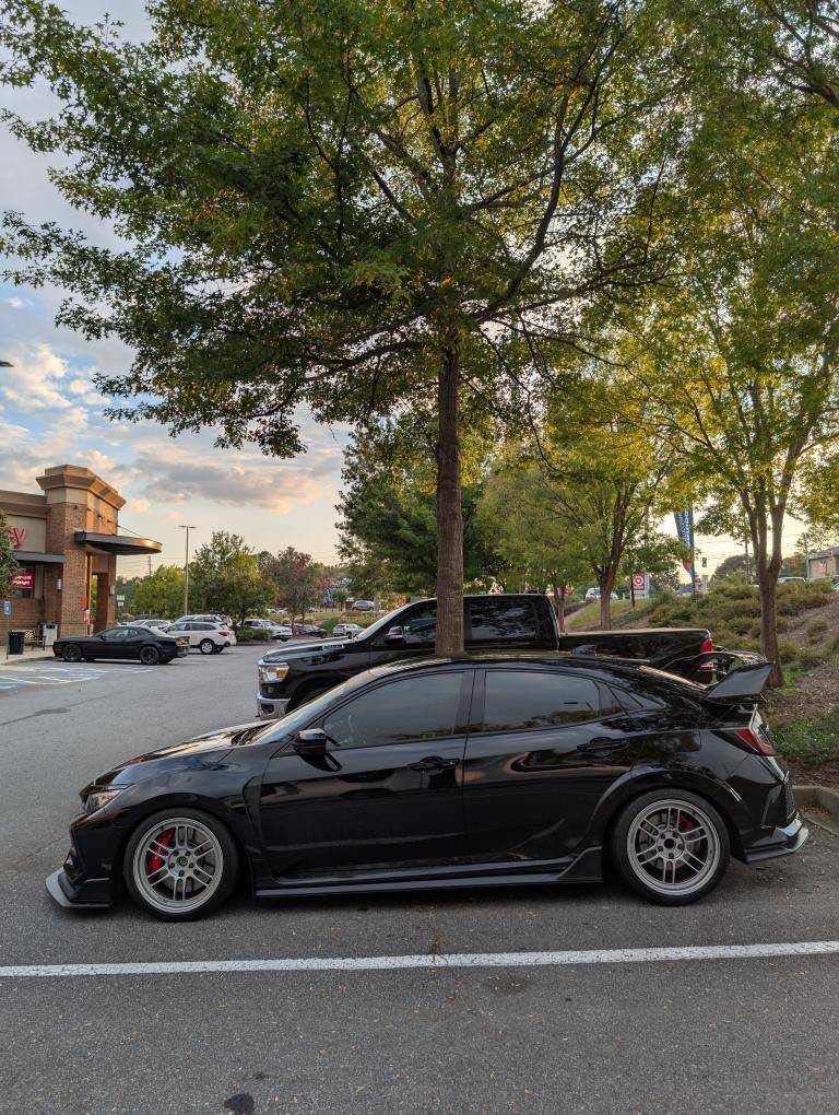

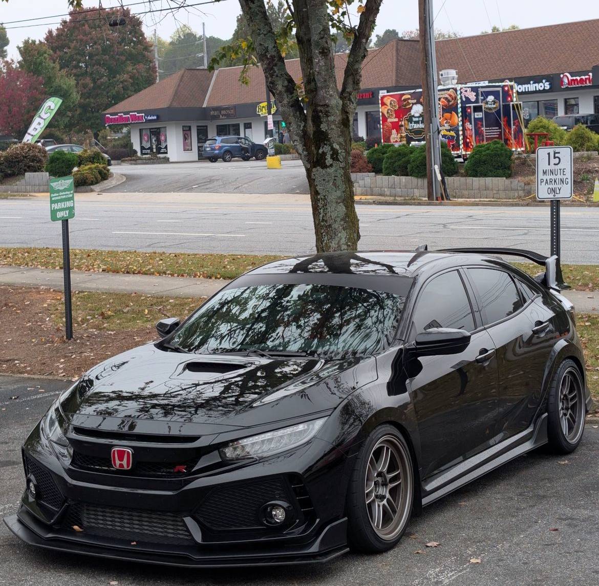

Hardly seen on FL5’s is the infamous RPF1’s, but I think it’s still one of the best looking wheels.
With the exception of the only spec that Enkei offers for our cars that fits out of the box
it is fugly
Luckily I found Anthony, who fit a proper spec on their FK8, and he explains what he did to make it work. I would imagine the exact same would work for the FL5.
What do you guys think? Has anyone already done this on their FL5?
Does anyone know for a fact if the FL5 accommodates more aggressive offsets than the FK8 without rubbing?
Any relevant pointers or tips are appreciated.
Credit goes to @anthony.fk8_ on IG
