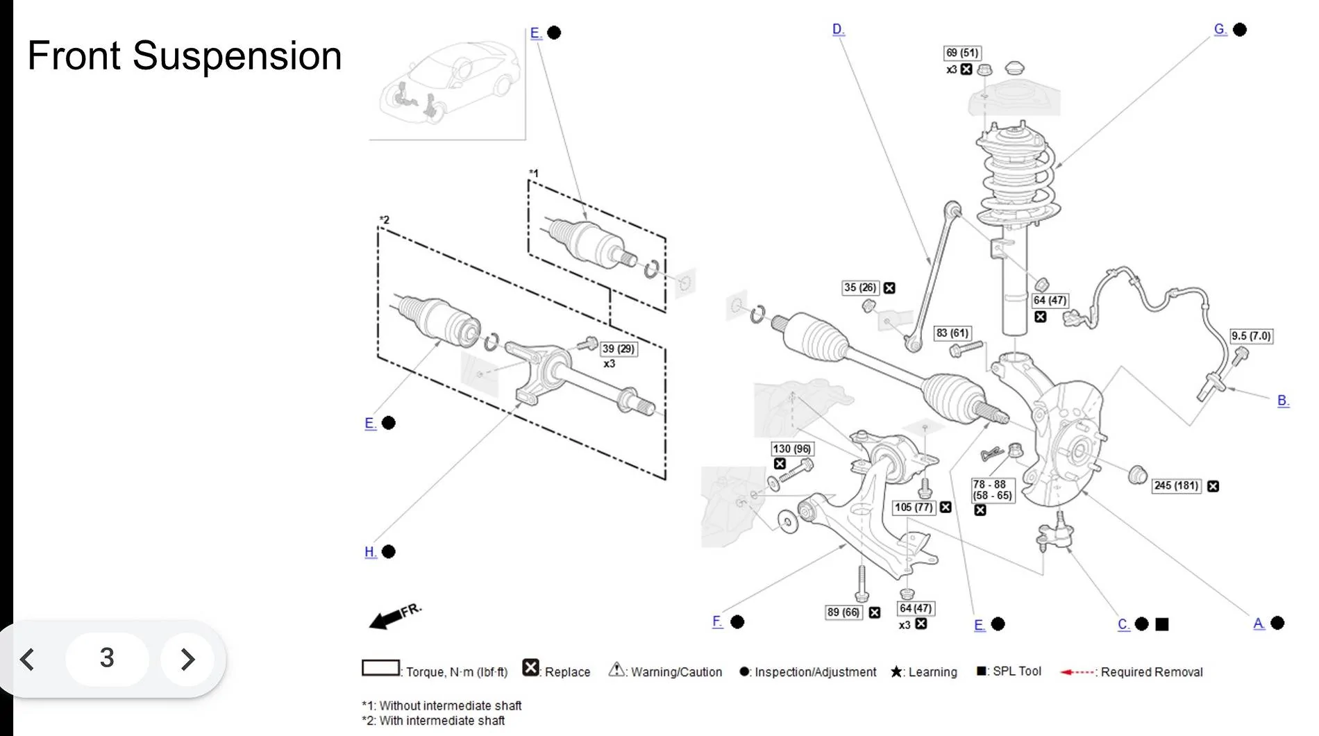

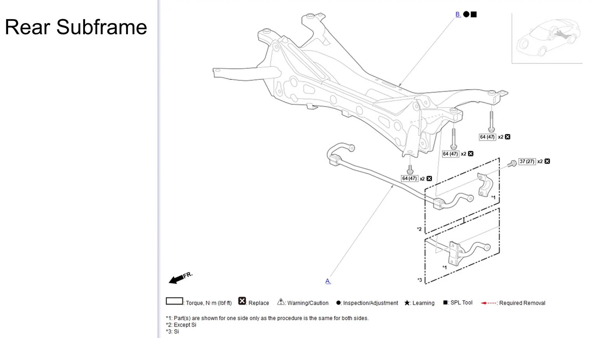

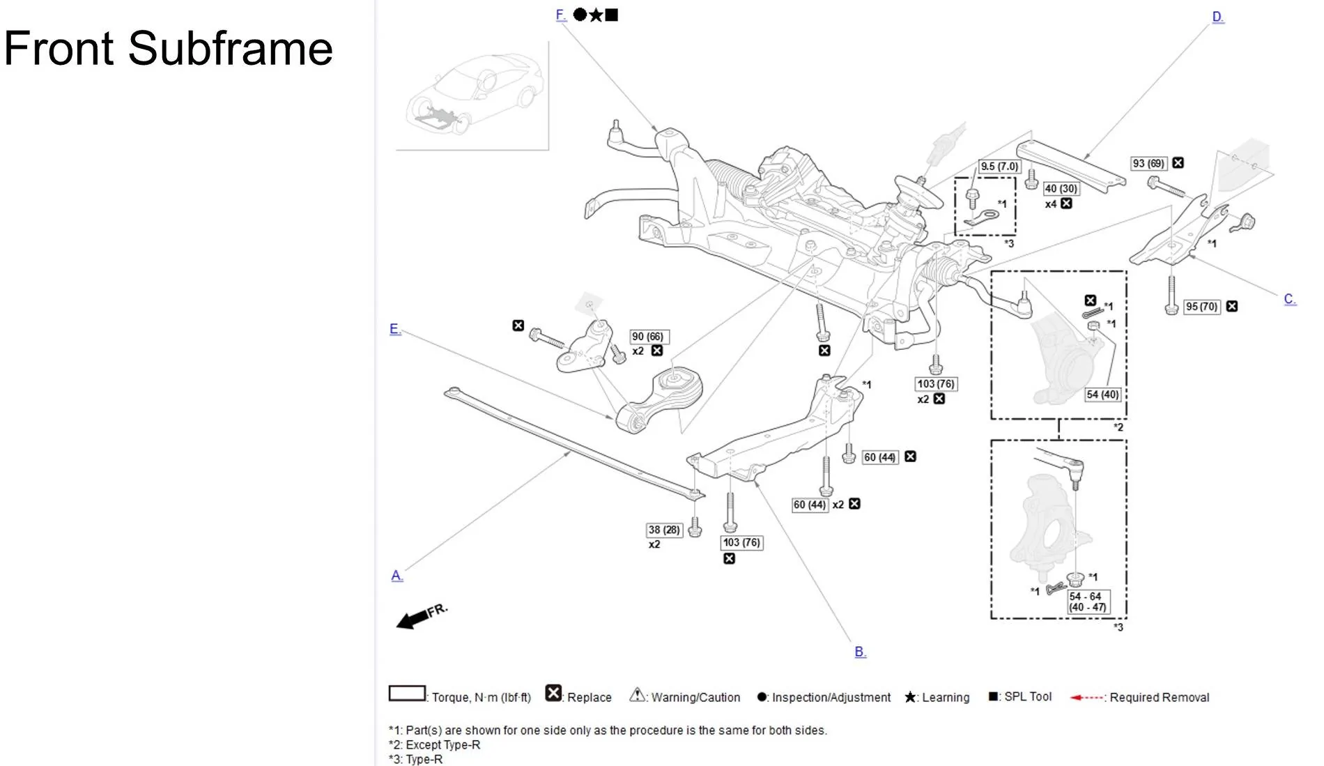

Recently ordered some rigid collars (front and rear) and thought I would see if I could be able to spend some time and maybe save labor money by installing them myself. Does anyone by any chance know the bolt torque specs for the current gen (11th) civic (si)?

Since the 10th and 11th gen is vastly similar, I would trust the 10th gen Torque spec.

Attached are the torque specs from the relevant areas (I went through the install last year). These were pulled from the 11th gen e-manual.
11th Gen Honda Civic FE1/11th gen Civic Si bolt torque specs Screenshot_20250404_094553_Slides
11th Gen Honda Civic FE1/11th gen Civic Si bolt torque specs Screenshot_20250404_094528_Slides
11th Gen Honda Civic FE1/11th gen Civic Si bolt torque specs Screenshot_20250404_094513_Slides
