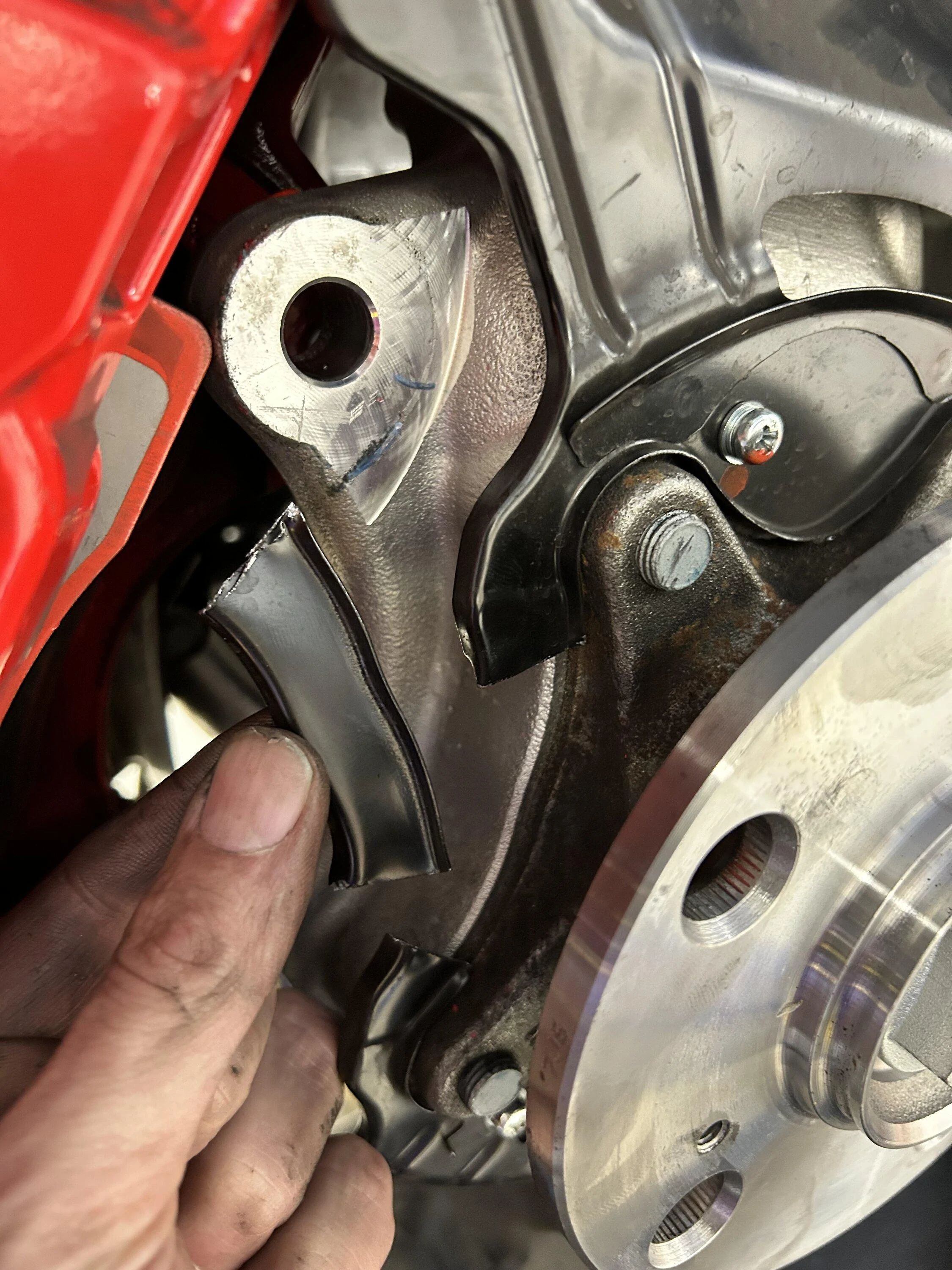

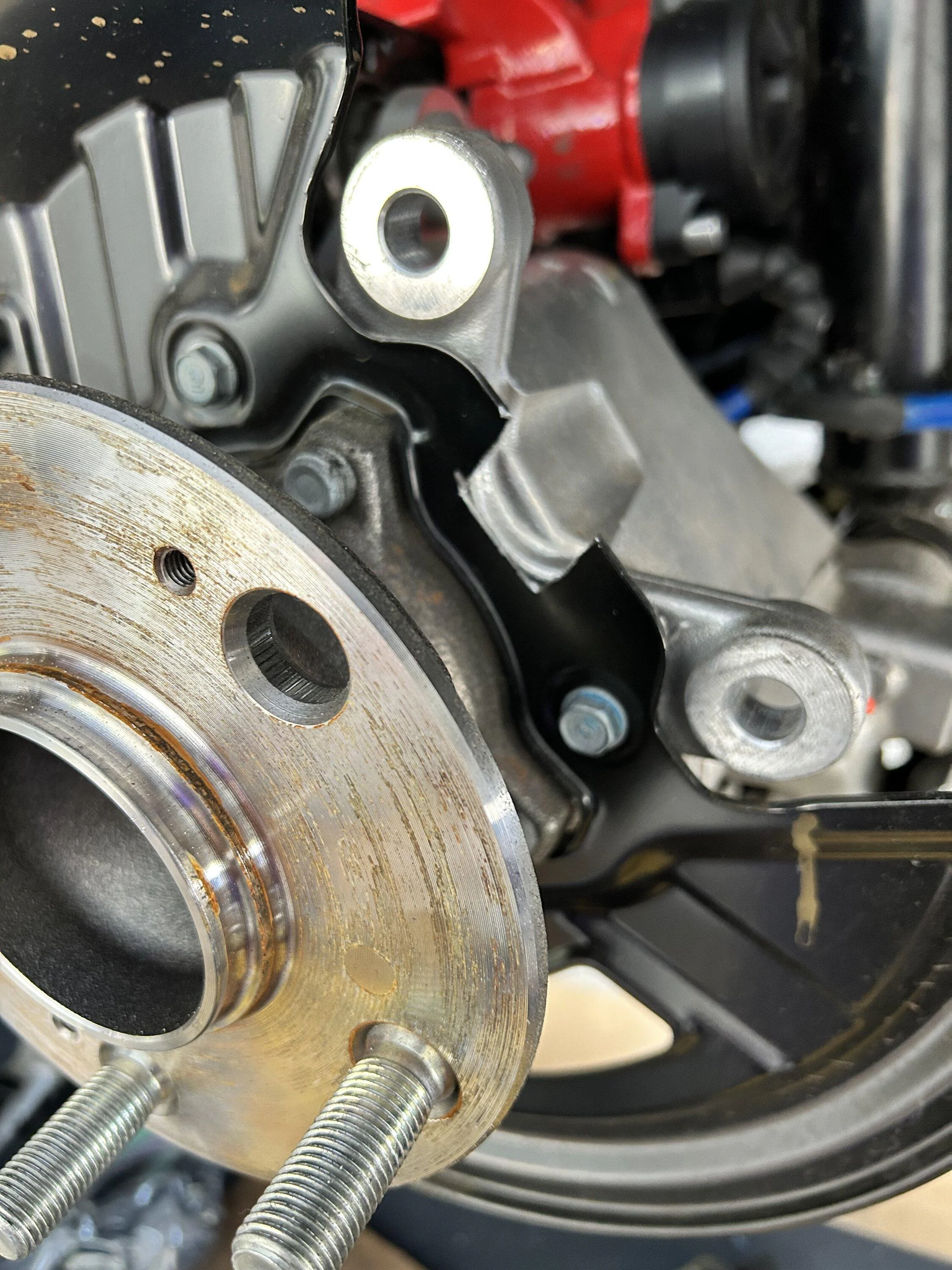

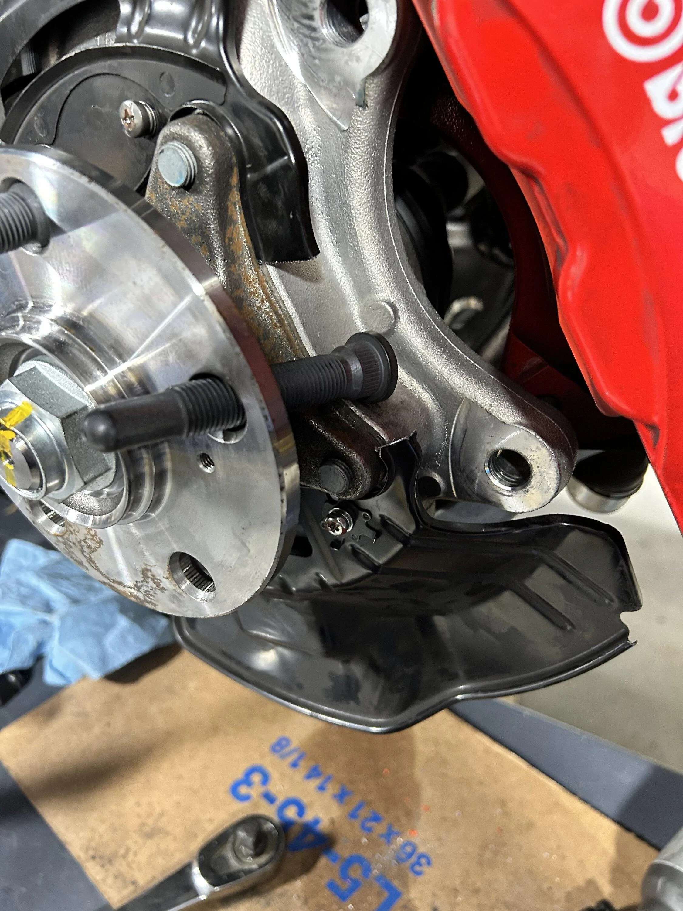

FYI for anyone doing extended studs on the fronts, you do not need to cut the heat shield.
Just PB blast the 3 screws holding the shield and maybe use an impact screwdriver and they come off easy. You can then rotate the heat shield to make clearance to install whatever extended stud. Overall very easy install.
