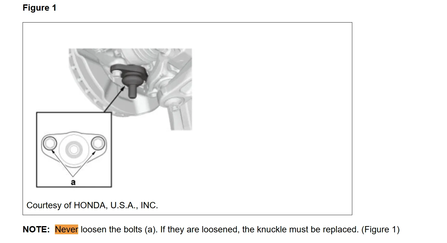

On the hunt for some more camber, and these ball joints gave me tons! My preliminary alignment readings were over 4 degrees of camber, which is way more than I want! I have these joints set in the most aggressive setting and plan to move them to the middle setting instead! Install is pretty easy! Plan on an hour to an hour and a half! Car is on stock suspension with the strut pins pulled! My goal is to hit roughly -3.2 degrees of camber, which is easily doable with this kit!
Alignment alert!!! You will need one immediately following install!!!
