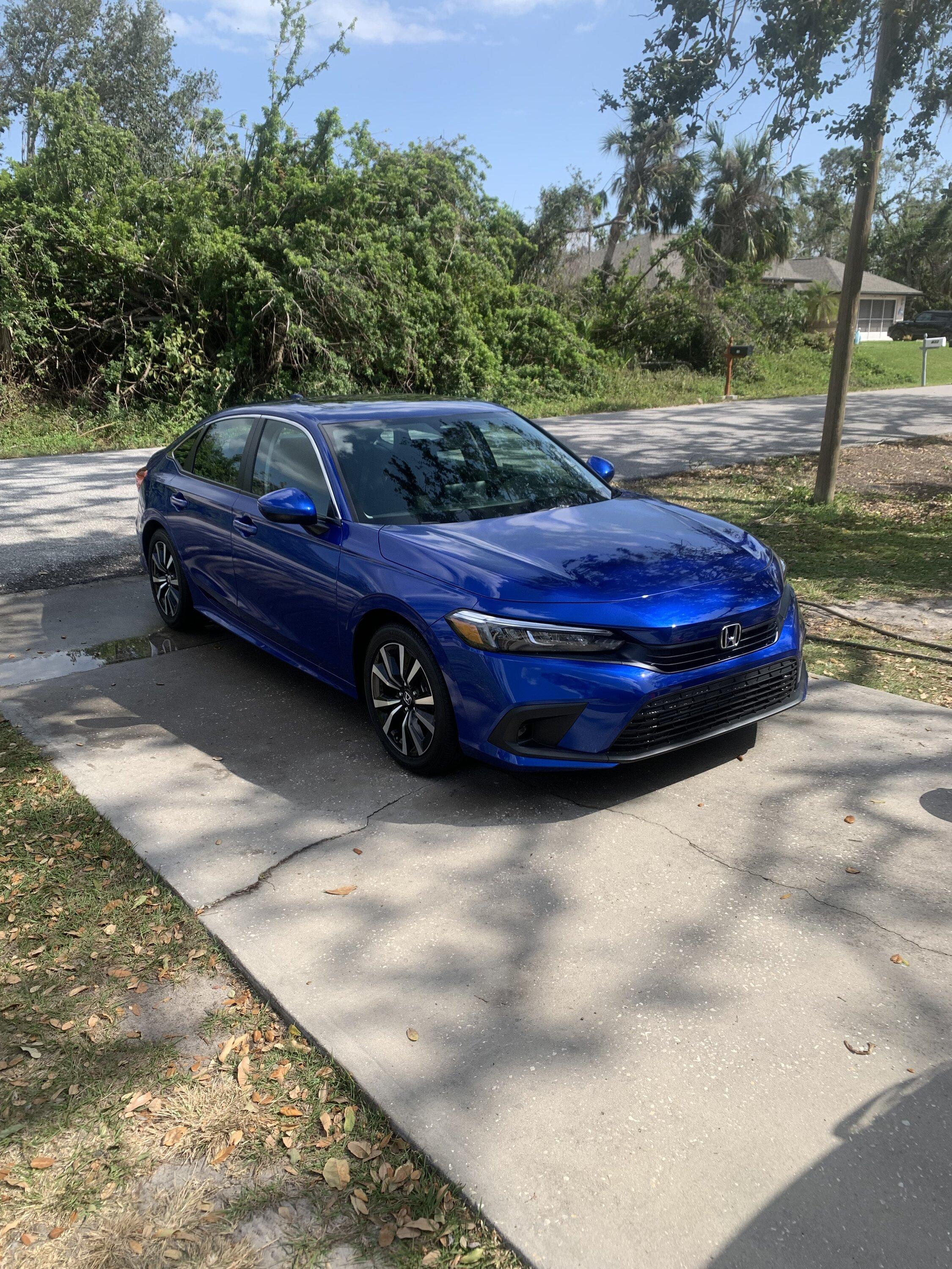

Taking the car into Honda tomorrow morning we’ll see what they have to say BTW my EX is the same color as your SI actually Rallye Red was my first choice
