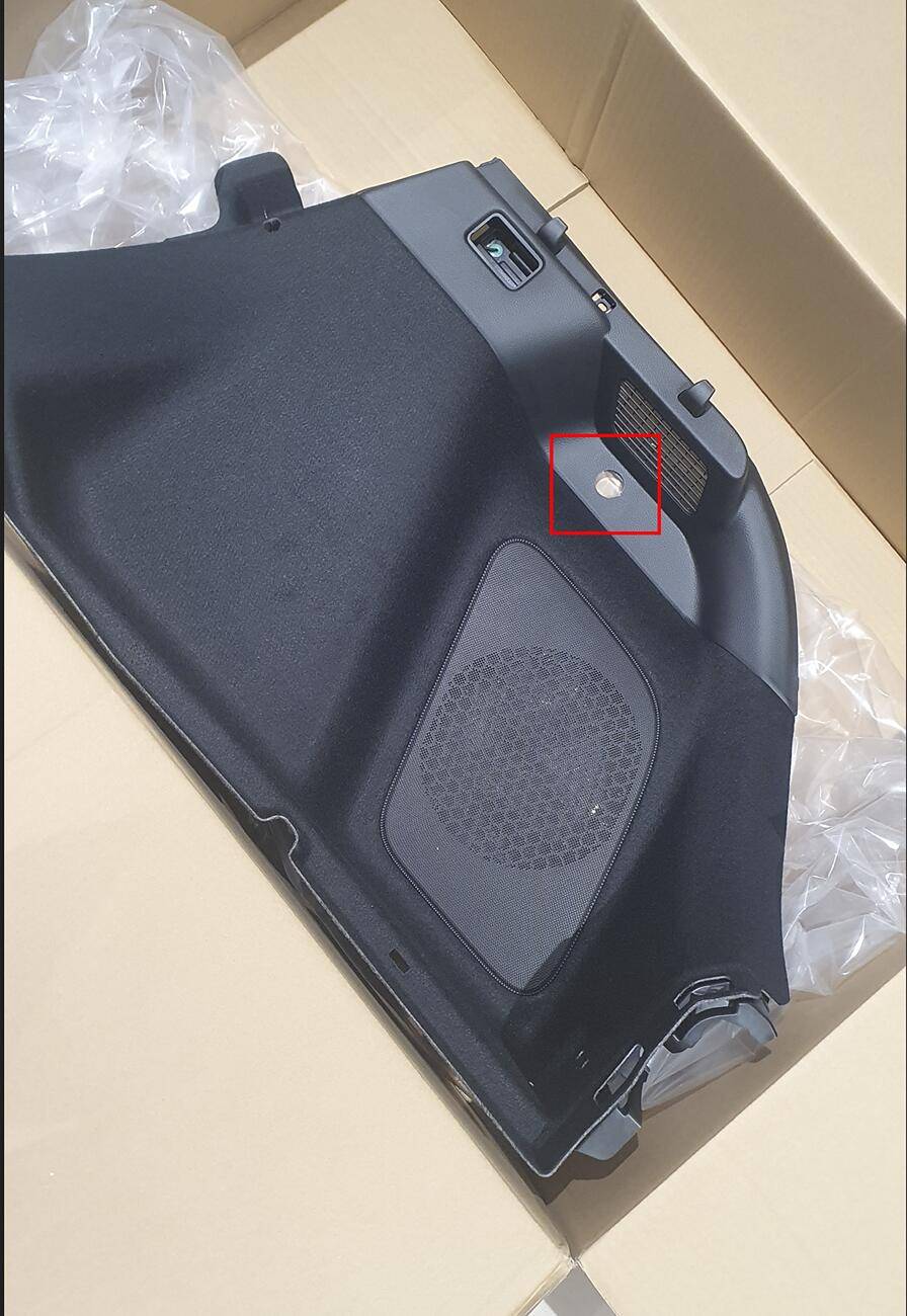

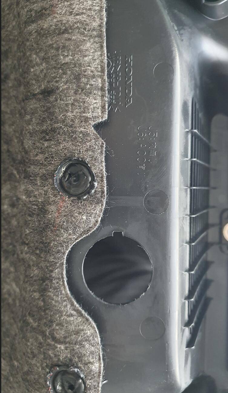

In the entire parts collection, I am missing the catalog number of the right side and the subwoofer cover in the trunk. I managed to find the catalog number of the Bose subwoofer itself - 8A445-T43-A01, but I don't know the exact catalog number of this side panel...
I found these variants:
- 84601-T47-A51ZA (Sport Touring version)
- 84601-T60-A51ZA (probably Type R)
Do any of these elements fit the Type R and is it a complete side panel or do I need to buy the cover separately?
