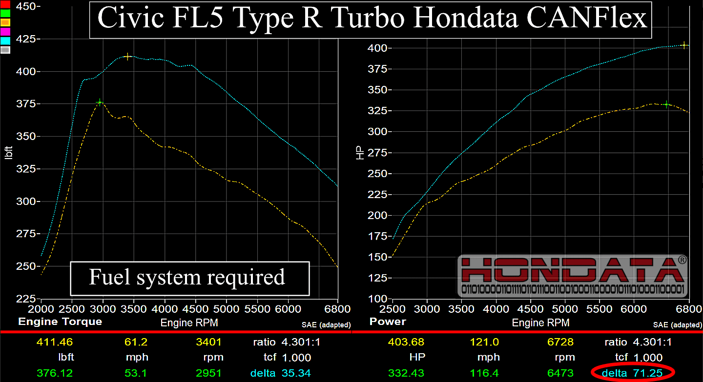

This all stock, or no?
Yes. The car is stock. Stock intake, intercooler, and exhaust. We tested all these to see what made power and posted the YouTube video and results here. Short story, the FlashPro made the most power and torque. The next best bolt on is now CANFlex.

So did the car have your fuel system plus the flex kit?
Says fuel system required.

What about the fuel filter? I thought these are prone to dissolving in higher ethanol levels?
Brazil runs 28% ethanol at the pump with similar fuel tank components. We've been testing ethanol for years and have seen no fuel pump or filter problems.

So this basically will be plug and play and I won’t have to be blending ethanol with 91?
Jester04
1,971
2,467
You still have to blend unless you have a massive fuel system to support the fueling requirement. This just allows the map to self adjust depending on ethanol content without having to switch maps.

so this will still be fairly advantageous for a fairly stock vehicle?
Websitesdown
Jun 17, 2024
264
167
According to their site dyno chart you'll get around 372hp stock everything with this and their base maps utilizing their tuner of course. Elevation and temperature differences outside will change things a little for people of course I'm sure.
I'm gonna guess a smidge better with a custom tune as well. That's a pretty good jump IMO.
Having better quality fuel lets you push the car further. So yeah it is a great option, but to truly take advantage of it I would recommend a fuel system. But it will still make power regardless even on stock fuel system, you will just be more limited in the amount of ethanol you can run.
