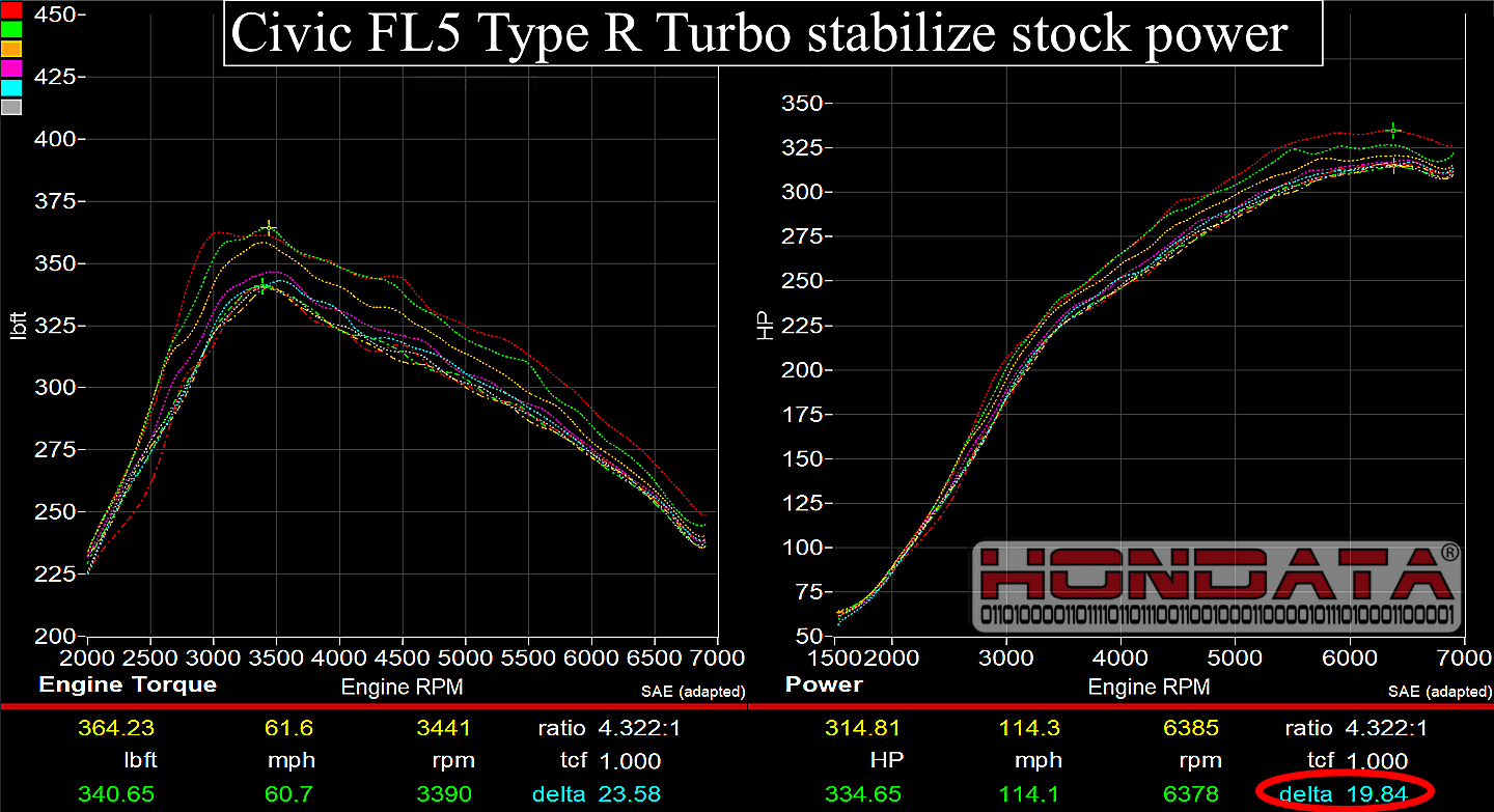

We took our FL5 to the dyno and tested some basic bolt-ons and compared each to stock.
Thanks for the data, Doug from Hondata! I was looking into buying an intercooler, but your findings are giving me second thoughts. When would you recommend an aftermarket intercooler compared to an OEM one?
An intercooler will cool the air more and probably deliver better performance than our test, because on-road, you pass a lot more air through the intercooler. The downside is a possible reduction in throttle response.
So, when would be when you are making more boost because of the Hondata reflash, and after you have an intake that injects more air.
